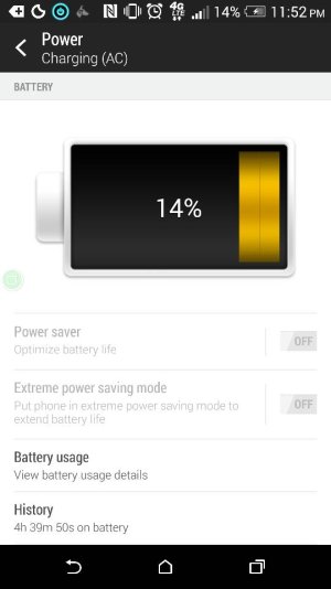

Re: Problems with my HTC One M7
Sorry, I didn't mean an actual notification in the notification bar. I meant on the Settings>Battery screen--does it say "Charging (AC)" when it's plugged into the wall?
Yep, I'm wondering if my battery has gone bad at this point.
Tapatalk'n On The M8 ☕🐸

I can see that the power saving modes are grayed for you, so I assume that you have the high performance mode enabled, which could be the reason for the slow charging.
Sent from my HTC One M8
