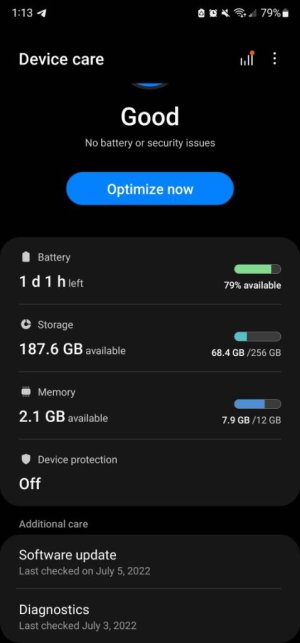

OP here, thank you for your help. I had a look at device care and there didn't seem to be a diagnostics option but I had a look at the various bits it did have, Battery, Memory etc. and everything looked ok. I think a faulty USB port could be the issue. Any ideas how easy that is to fix or how expensive it is to get repaired, roughly? Are there any other ways of charging the battery other than via the USB port? I'm not sure my phone (Samsung Galaxy A12) has the ability to use wireless charging.
