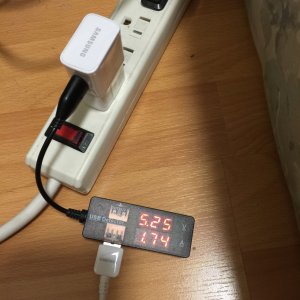

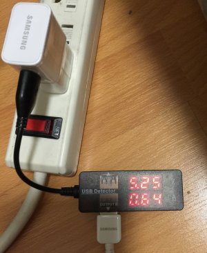

Anyone should have a current and voltage USB tester which is around $5-6 on Ebay to verify if your cable or adapter or USB charging port is working properly. Reading the voltage and current display will help you identify problem quickly without guessing. This little tool is worth the money as I have seen too many posts and they have no idea what is wrong when their tablets are not charging properly.
usb current and voltage tester | eBay
Without any tool it's very difficult to identify which one is at fault . Full charge only takes around 4-5 hours with good adapter and USB cable.
But in some cases, battery takes a long time to charge with good cable and adapter, then the problem may be from USB charging port or bad battery connector from motherboard. Battery's capacity fluctuation is either bad battery or battery connector, but the connector is more likely.
You need step by step, start from adapter, USB cable, USB charging port, battery connector, then the last one is battery. The worst case is defective charging circuit on main board , you can only make this conclusion if all previous steps have been done.

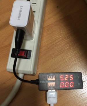

Something is wrong, the tablet is not charging, swap one by one: adapter, USB cable, USB port to find which one is defective.
Something is wrong with the adapter or USB cable or USB port or battery connector, unless the battery is full:
This reading is normal, the tablet is charging. Adapter, USB cable, and USB port are working. If battery is not charging fast enough, time to inspect battery connector and battery.
