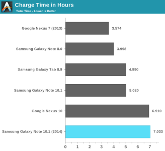

Is your tablet Exynos or Qualcomm? The Exynos tablets take forever to charge and it has nothing to do with amperage-in. I went from a Exynos N10.1-14 to a S-800 Note 12 and the latter, in spite of its much larger battery, gets from zero to fully charged faster. In terms of the charger, it might be the USB cord you're using. I got an angled USB cord to charge my N10.1-14 in its stand and charging time increased about 30%. And that's connected to a Samsung wall charger.
It takes the N10.14 seven hours to fully charge. The Note 12 has a 15% larger battery so normal charging time would be eight hours.
