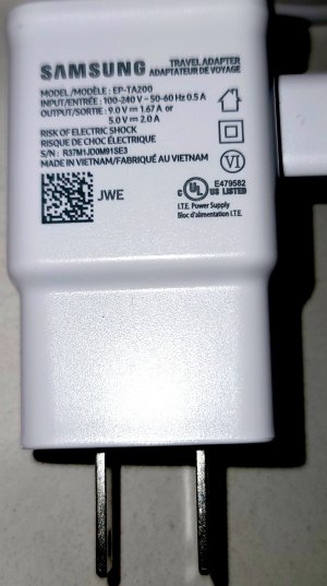

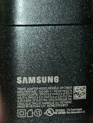

Visit site
as i was in a rush to pre-order right after the Samsung Unpacked video presentation, i didn't look closely enough at the accessories for charging and thus, i ordered the incorrect 45-watt fast charger, thinking that as the S20 Ultra specifically can use the 45-watt fast charger, there's no reason for them to make it NOT compatible with the S21 Ultra and force us to downgrade to a 25-watt charger - WRONG!
apparently, only the 25-watt charger is listed as being compatible and the 45-watt, by inference, is incompatible. very odd.
looking over the chargers that i have, which all of course look similar, i read the fine print on a few of them and they are very different:
the black charger is the one that came with my S20 Ultra:
EP-TA800 (came with my S20 Ultra)
Input: 100-240V, 50-60 Hz, 0.7 A
Output: PDO: 5.0V 3.0A or 9.0 V 2.77A
PPS: 3.3-5.9V 3.0A or 3.3-11.0V 2.25A
additionally, i have two others that have identical specifications but have DIFFERENT model numbers:
EP-TA20JWE and DP-TA200
Input: 100-240V, 50-60 Hz 0.5A
Output: 9.0V 1.67A or 5.0V 2.0A
Wonder which one(s) are best suited for the S21 Ultra without causing damage and yet takes best advantage of its fast charging capabilities?

For example, what if one would use the EP-TA200 or the EP-TA20JWE (identical specifications) on the S21 Ultra? would it still function fine and would the S21 Ultra be "happy" with it and the only issue is that charging would be slow?
Or, would the output be so low that the S21 Ultra would NOT be happy with it and it can thus cause problems?

Both of the chargers you listed will work fine. The first at 25W and the second at 15W
The 45W charger you bought from Samsung IS compatible with the S21, but obviously will only charge at 25W.
thanks for the comment/advice.
if the 45-watt charger is compatible with the S21 Ultra and will NOT cause problems, why wouldn't they show it properly on samsung.com? i went to their mobile accessories page and selected my new phone, the S21 Ultra, and selected power accessories, and it ONLY gave the 25-watt charger as the only option!
may i ask how we may be certain that the 45-watt charger would be properly recognized by the new S21 Ultra and it will tell the charger to NOT use its full 45-watts?
