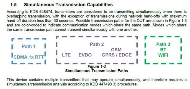

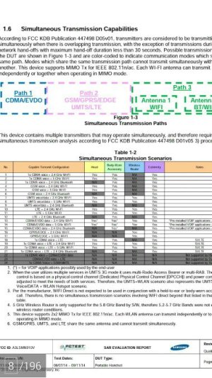

I think that you are confusing cellular paths with antennas. The 4GLTE devices even the iPhone has at least 2 cellular antennas, however devices after 2014 only had one cellular path (but still has more than one antenna)
My old rezound and s3 also supported svdo. There could be other devices, but I am not sure.
Yep, cellular paths, thanks for the correction. The result is the same. I'm not sure why they stopped this: the phones were more complicated to design? Qualcomm stopped making the radios that supported this design? The power effects? Verizon wishing to market their VoLTE service? A combination of these?
