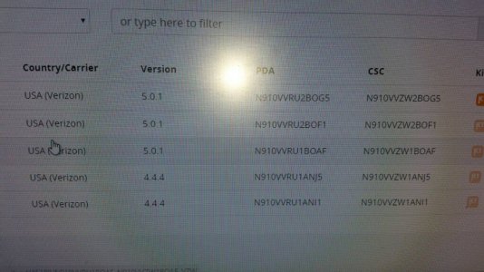

Also....there are other Firmwares Available on Sammobile...4 more to be precise. I would try the newest firwware, ending with BOG5.
Re: Note 4 wont boot. Kernel Fail
Here are the others. Also....try using a different version of Odin, perhaps 3.07...that's the one i used the most. Make sure you right click, and run as administrator. Also, try a different connection (USB) port on your PC when trying again with newer firmware.

I did see those and I tried the first one in your screenshot yesterday and it failed too. Since it was the 5.0.1 version (Lollipop) I realized that the Note 4 originally comes with Kitkat 4.4 stock, so I tried that and same result.
I have narrowed it down to it being an Aboot issue (Application Bootloader) which is what runs first and boots the Android kernel/Recovery kernel.And this is where I am stuck at, at the moment. Trying to figure out if there is any way to fix that.
