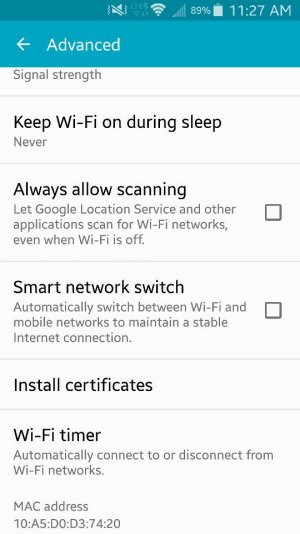

Devenchi
Jul 31, 2012
46
Re: My S5 won't stay connected to wifi.
Turn off Smart network switch
