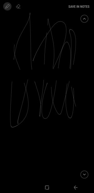

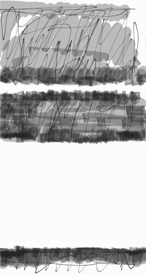

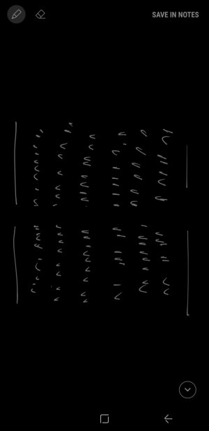

When using the S-Pen there is about a 1/4"-1/2" space in the middle of the screen the runs from the left edge to the right edge of the screen where it will not write. For example if I take the pen and start at the bottom of the screen and go to the top, and back to the bottom, and back to the top - there is a section in the middle where it does not write.

If you have the need to tap in that area, does the device respond to the tap. You might also try taping with the stylus in that band and see if it picks up the tap. Let us know what you find.
BigRedGonzo
So, since the S-Pen doesn't work in that area and the phone doesn't recognize a tap in that area and you have no magnetic interruption. The last thing that I would recommend trying is removing the screen protector and seeing if that makes a difference. If it is a Zagg, then you can get a replacement, otherwise... If you still have the issue without the screen protector on the phone, then you have a bad display and should return the device for another. If removing the screen protector works, then you had a bad screen protector and that is easily remedied (but usually not cheaply.) Let us know what happens.
BigRedGonzo
My guess is that the digitizer has gone bad / broke... Experienced some pressure in that area maybe. Basically looking at a screen replacement that includes the digitizer.
