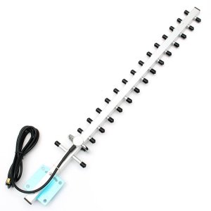

i plan to connect a 2.4ghz antenna to my cell phone HONOR 8X through USB (Micro B Charger Cable)
does the phone use the antenna automatically? how to make use of the antenna?
That looks like a coaxial antenna. This type of function is not part of the USB standard, it's not likely to work. The only way you might get an external antenna to work would be to use an external WiFi card if Android will support it through OTG.
