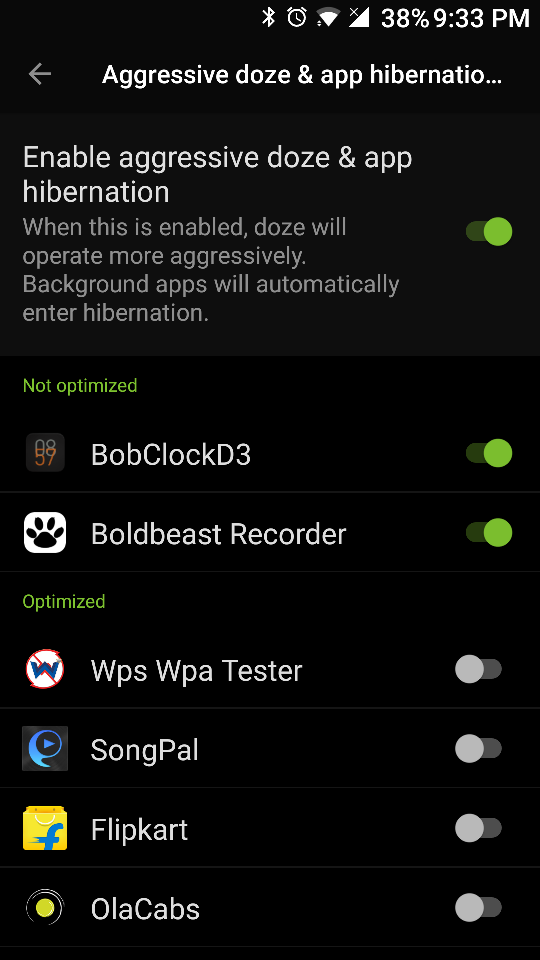

Just a thought... have you made sure to exclude all widgets from, "Aggressive doze & app hibernation"?

Settings > battery >4 dots and then add the app as below
Basically they need to be not optimized. Same happened with my bobclock widget which stopped updating after 4.0.3 and then it worked after I added the app as above
