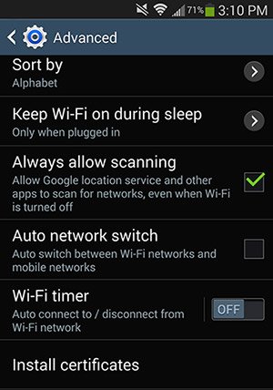

For what it's worth, I have a Galaxy S4 and a Nexus 7 (both running Jelly Bean, though the Nexus 7 tablet is now on 4.4) and the Nexus 7 has zero trouble with connecting to 802.1x EAP / PEAP network. However, the Galaxy S4 experiences problems remaining connected to the same network. Today I happened to find a solution to keep it connected, though the notification about the internet connection being slow or unstable continues to pop up -- despite the fact that it's fine when browsing. If you use the menu button while in the WiFi networks list and choose Advanced, you will be presented with the following menu. The option "Auto network switch" is enabled by default. If you disable it, the wireless network will stay connected. As I said, the message about the unstable or slow internet pops up periodically, but the connection remains intact. (If someone knows how to disable that notification, we'd be golden!)
Anyway, here is the screen I am talking about:
