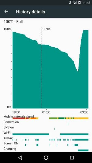

Even with wifi turned off it appears on in the battery usage data. Mobile standby is also the highest usage.
Any ideas?
Go to settings>location, hit the three dot menu on the top right and click scanning. Now turn off wifi and Bluetooth scanning.

My WiFi has always been on even after disabling scanning options... I just put it down to maybe it's a glitch--I clearly have WiFi off and it hasn't affected my battery (i dont think). 🤔
i disabled both scanning options, after a factory reset, but still have wifi on in the battery settings :(
Could be this running with Wifi Assistant..I uninstalled it and Wifi doesn't show up in my battery unless turned on
