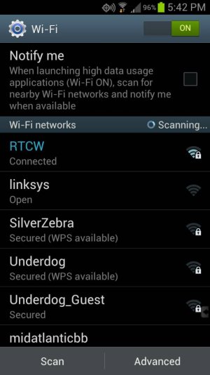

I'll agree that if you're in the Settings -> WiFi menu, you'll see that about every 7 seconds WiFi shows ' Scanning' as it updates the current list of SSIDs.uploadfromtaptalk1350434732367.jpgBut that appears to be normal behaviour for this phone. I don't see it connecting/reconnecting, though. The only time I see that pop-up that you're referring to
is when I wake the phone up from a screen off state or if I turn WiFi on and it connects.

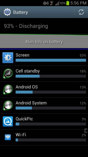

So I'd have to suggest that your battery issue is due to some other app running amok. Have you looked at the Settings -> Battery page to see what it shows? It should be a screen something like this that shows the major power users.uploadfromtaptalk1350435488471.jpgSent from my rooted, debloated, deodexed Sinclair ZX-80 running CM -0.001 using Tapatalk 2
