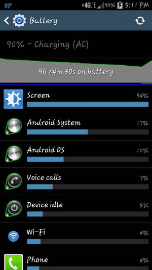

Does anyone know why this consumes 4% of my battery when I don't even have it turned on?

Are you using any location-aware apps? Some of these can actually turn your WiFi on to get their location, even if it's just for a moment and no, you wouldn't get notified about it.
1) It consumes 4% of your battery, or 4% of what's consumed (which could be less than 1% of your battery) is being consumed by wifi? (The battery app shows the percentage of total use used by that service - add up all the percentages and you'll ALWAYS come up close to 100% - IOW, 100% of what's being used is being used. That could be 1% per hour of total battery capacity.) Anything using 4% of total usage is considered a VERY low battery consumer. (The CPU - just idling, not "doing" anything - uses about that much.)
If wifi is consuming 4% of your battery per hour, that's abnormal even if it's on and connected. That would probably indicate a corrupted modem (part of the firmware) or a hardware problem. The whole phone shouldn't be using much more than that.
2) If you have scanning enabled, the wifi radio wakes up every so often to see if there are any wifi signals nearby.

Is this consumed or what's consumed in regards to my battery life?
Sent from a device beyond your wildest dreams!
That is 4% of what has been consumed, not 4% of your total charge. So 0.4% of your total battery capacity has been depleted by the WiFi.
Do you have WiFi scanning on like rukbat suggested?

No Wifi scanning on at all. I just turn it on when I get home.
