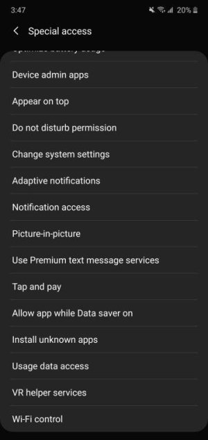

Also go to settings>apps>3 dots upperright corner tap > special access>scroll to wifi control make sure things are toggled off to control wifiScreenshot_20200328-154759_Settings.jpeg

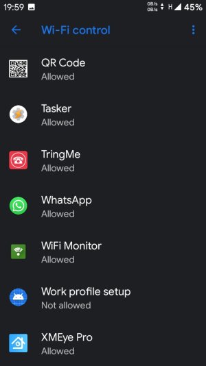

I have looked under WiFi control as you suggest (good idea, thanks) , and there is a list of apps which can control wifi. I have turned off "work profile setup" because it sounds like a system app. The others look like regular apps. I will try to attach a screenshot. Screenshot_20200328-195941.jpg.

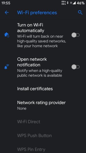

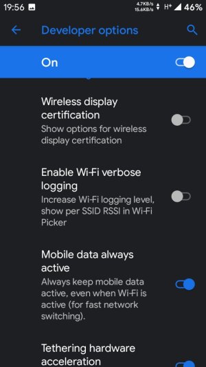

These are my wifi options.Screenshot_20200328-195518.jpg, and the developer options for wifi are here. Screenshot_20200328-195604.jpg.

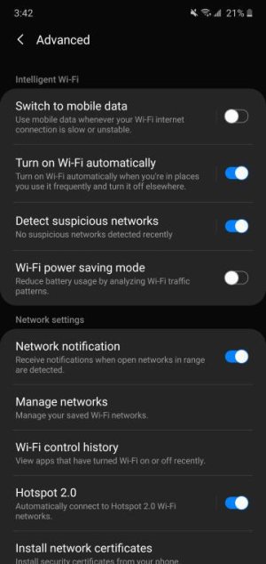

Ok that's good work profile might interfere, also toggle on automatically connect wifi in known places

OK, so after a day of testing, the phone now does seem to work OK and WiFi does not now switch off when the screen goes off and the phone dozes.
The fix appears to be to stop "Work Profile Setup" from controlling the WiFi. The procedure might vary slightly on other Pie phones but on mine it was:
Settings / Apps and Notifications / Special App Access / WiFi Control - then 3 dots at the top to enable "Show System". Scroll to "Work Profile Setup" and switch this to "Not Allowed".
