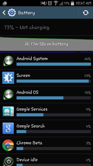

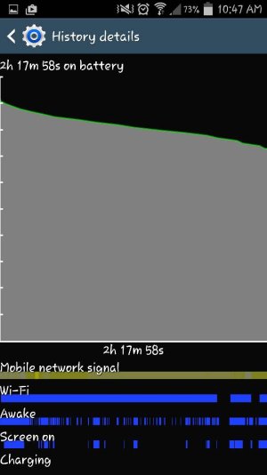

Wi-Fi is keeping phone awake. I set WiFi so it would go off when sleeping but haven't tried it. As u can see when the WiFi is off my phone isn't awake.

Something is waking your phone repeatedly. If you must leave wifi on overnight, make sure that Location Reporting is set to Battery Saving Mode....or Off if you don't want any reporting. Make sure that your Email and Accounts are set to sync at sensible intervals. Your Mobile signal looks bad....switch off at night, otherwise the phone may be searching for a signal and draining battery.

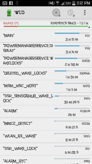

You could consider installing an app such as Wakelock Detector, to find what is keeping your device awake at night.
I will have to do that tutorial tmrw but this is the kernel wakelock.
