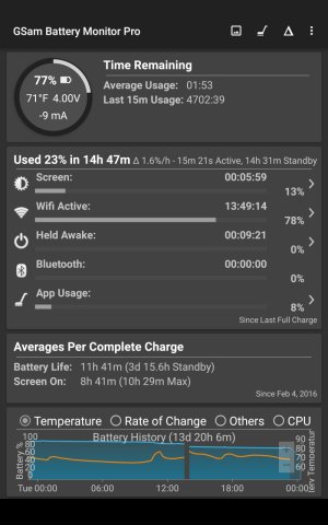

Check out these conflicting battery reports. Wifi set to 'only when plugged in' and no scanning; Location set to device only. Charged to 100%, took it off charge at about 8pm and used it for about five minutes at 11pm, then set it aside for the night with battery still showing 100%. Today's first use of the device (almost 15 hours later) revealed this GSAM report:
Note the 23% battery loss with only 6 minutes of SOT and 9 minutes held awake. Note also that the Wifi on time is almost an hour less than the time off charger. According to GSAM, wifi was 78% of the battery usage. The 8% app usage was all Play Services (23% x 8% = normal 2% battery usage over 14+ hours).

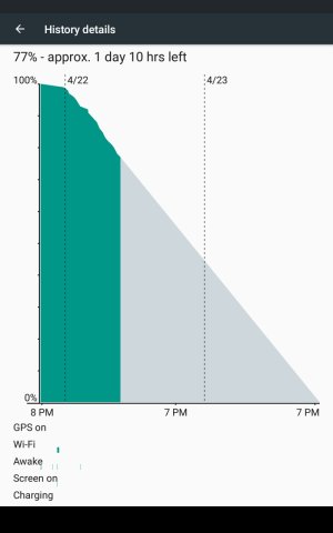

Now check out this system battery report:
Note the system sees wifi as being off! Shows just the 11pm SOT and brief wifi associated with that, and shows virtually no wakelocks. Very strange.
