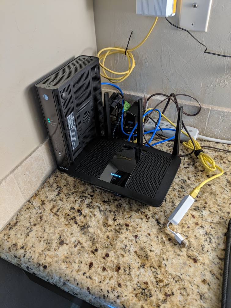

I also need to figure out what to do so I don't have to look at this mess every day... For some reason on this house they put the power outlet and att box (converts the fiber to cat5e) ABOVE this counter instead having the plugs near the floor...
Hey, that looks like my counter!:p
Maybe get a little monitor stand or something like that, put the modem under the stand (which can hide the cables) and the router on top?
Ahhh, I didn't think about something simple like that...

That's what's actually in the picture. Linksys is hooked up to the modem/router and is what my wifi is being broadcast on now. It's just currently a mess of cables bc this location is not at all optimal for organization...
In addition to Reg Joo's suggestion, you could probably run an RG-11 cable from the internet connection (with a double-female if all they give you is a cable with no outlet - I can't tell if that outlet is live of not) to under the countertop, then get the box off the wall and mount it inside the cabinet. (As long as it doesn't get too hot in that cabinet in the summer.) Or you could run it to the basement or another room. (And shoot the supposed-technician who installed things that way. Back before the break-up, when it was all Bell System, anyone installing a phone that way would get fired for total incompetence. We ran wires into hidden spaces as much as possible. [My kitchen wall phone had no wires showing - they ran through the subfloor and footer, through the kitchen wall, then out to the phone jack, which was covered by the phone. And, no, I didn't do it myself, I was at work when my wife watched the installer working at home.])
There's a right way of doing things, a wrong way, then there's the easy way, which is "wronger than wrong".
So you can't see in the photo (I'll take another picture later) but this is like a built in desk that has a granite top that matches the kitchen granite. It's just off the kitchen. There's a cabinet up above it which I've considered relocating things to but what makes this thing a pain is that ALL of the connections/outlets are above the desktop, even the power outlet. It worked for the previous homeowners bc they had a giant iMac which covered everything but I just have a Chromebook.
