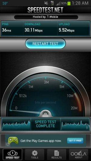

That don't seem right. I use my tmobile galaxy s3 and I live like hour away from city. I'm in pollock pines ca. I usually get pings of 14 to 38 on bad day and lte speeds up to 37mbps. My comcast internet pings at 39 and max download is 24. So. I use my tmobile Lte to play ps3. Etc
Sent from my SGH-T999L using Tapatalk 4
Just did screenshot like 10 mins ago
