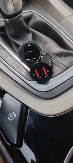

There are definitely car chargers that are built better and will charge faster than others. The top one is plastic and sucks so bad that my phone still dies while plugged in and using it for my music. The bottom one is made of metal and better quality all around. Charges way faster or actually charges it instead of delaying battery drain lol
