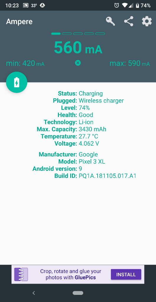

I have an app through the Google play store that tells you the speed at which your phone is charging. Also using a timer determined that having a thicker case on the phone it slows the charging speed. Google says this is not true. Can anyone give me any factual information on this? I have searched the internet. Thank you in advance.

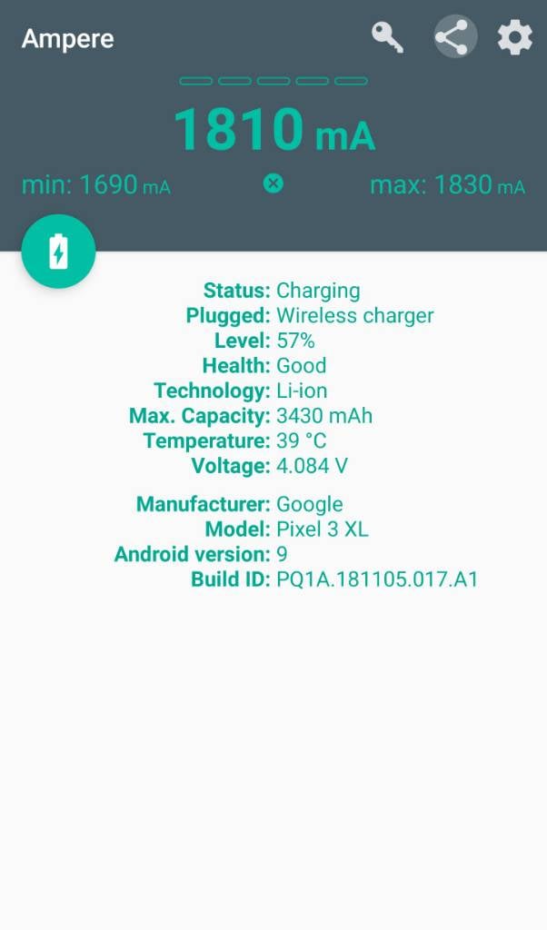

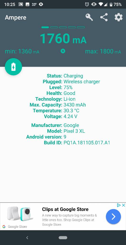

The faster charging speed is with no case and the slower speed is with a case. The app I'm using is Ampere. Pixel 3 XL using a pixel stand for the record.

Seems like you've already resolved the question with the evidence that you provided: clearly having a case on the phone causes the device to charge at a slower rate.
The electrical Flux lines of the charger get weaker with distance from the device being charged. If you want to convince yourself, take the case off the phone and put a piece of paper between the charger and phone; note the charging current. Add another piece of paper and keep repeating the process. As the overall thickness of the paper increases you'll see a decrease in the charging current until a point at which it won't charge at all.
