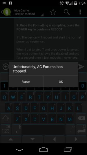

Apps constantly force closing. For example, this is the second time typing this post. The first time I was typing it on my phone and just before I finished.. blam ACFourms app crashed.
