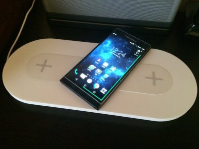

I picked up a wireless charger at IKEA yesterday... the NORDMÄRKE. They had them on display and I was able to test my PRIV on one before purchasing. They have a single size one and a long one with three charging zones for multiple devices.
Single: NORDMÄRKE Single pad for wireless charging - IKEA
Triple: NORDMÄRKE Triple pad for wireless charging - IKEA
Works fine with my PRIV. It's not super fast but it works and the charging zone is easy to find. Phone rests nicely.
IKEA has a few wireless charging solutions: Wireless charging
Here's a pic of my PRIV on the 3-banger.
