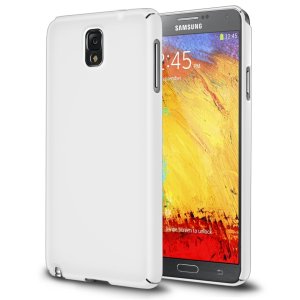

In case it matters, here is what I'm using:
  • White eBay Qi-compatible charging receiver:
  • TYLT Vu wireless charging cradle:
  • Rngke Slim Case:
