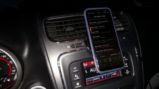

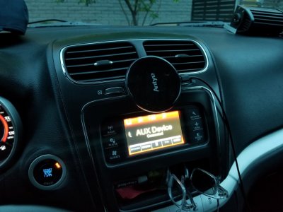

Please excuse it not being very bright. It's nighttime right now. Just got home from work and tried out my new toy. It works.
So, what it is is a magnetic mount that also acts as a recharger. And it works!
It's not fast charging, but it charges. I put on youtube and started playing. While it was playing youtube, the battery charges up a couple percent in a couple minutes or so.
Here is the product.
https://www.amazon.com/gp/product/B...ag=hawk-future-20&ascsubtag=UUacUvbUpU5789081
Instead of using the suction cup or vent, I simply used industrial strength mounting tape.
I can now convert 100% to wireless charging!
