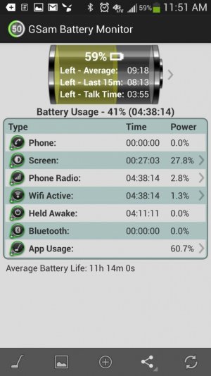

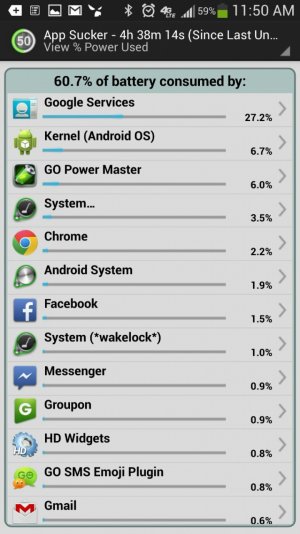

As someone who is still fairly new to Android I'm still less then impressed with the battery on the S4. As you can see from the screen shots I'm under 60% already and it's only been unplugged since about 715.
I'm hoping someone here can decipher some of the battery logs I've attached
Thanks
David

Of the 4h 38m your phone has been unplugged, it's been awake for 4h 6m - of course your battery is dying quickly!
Looks like you have the NLP wakelocks, it's a common problem. Googling them will help find some solutions.

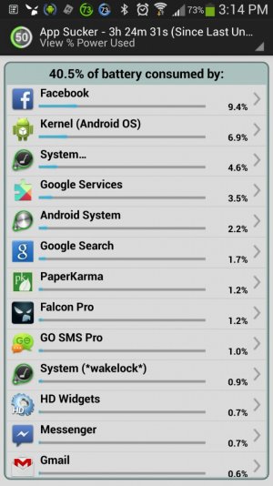

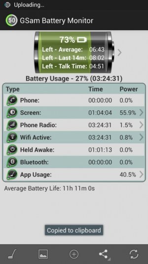

Appear to be doing better the last few days. Not really sure what I did except maybe clear the cache out in Google Services.
I am using screen auto dim and plug my phone in every night to charge while I sleep.
My phone isn't rooted so I'm not sure about removing some of the aforementioned apps but I'll try that next.
Thanks all for the replies.
