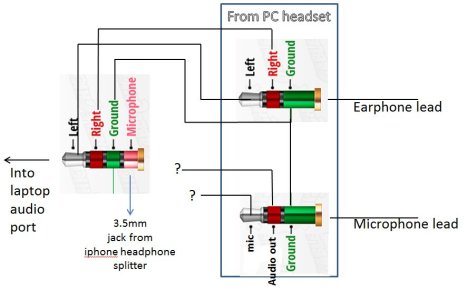

Do your earphones have separate cords for a microphone? Do they have a microphone at all? You'll see the headphone plug for a pair of headphones with a microphone built in-line like the ones that come with phones have 4 separate contacts (Left, Right, Mic, Ground) and a standard stereo headphone has only 3 (Left, Right, and Ground) when you plug a 3 contact into a phone, the contacts don't line up properly. You can buy an adapter for this.
*Ignore the "Into Laptop...." at the left of the picture, this is just illustration for the 3 contact and 4 contact plugs.
