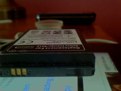

this is my samsung battery. marks are hard to see but they are there. the positive term is closest to the edge of the battery. cen ter pin is not used for charging.
