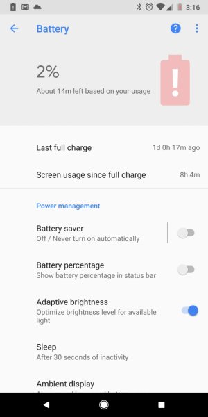

While I was letting the battery deplete, I used netflix and ran 2 different movies of 2hrs each, put some pandora, used instagram and played a little bit of best fiends. This is what it said I got. Not sure how true that is. Besides not showing a full charge the battery has been great. Way better than my old Nexus 6P Screenshot_20171103-151654.jpg
