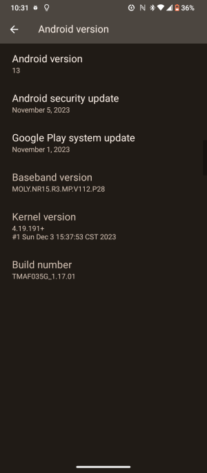

So wait ...then why, (though my phone isn't a Linux distro) in the near 1-year experience of Linux activity & learning (continuous settings analyzation & configuring/awareness) am I just now seeing Baseband in my settings moments ago?
WHY, isn't there 2 lines (one above the other)? And why does it start with MOLY.NR15? This HAS to be new, because this is the first time I've seen this in my settings or anywhere.

No offence, but you are replying to someone who hasn't been active in 4 years on a thread from 13 years ago. Have you considered that maybe you're awareness isn't quite as good as you think it is?
