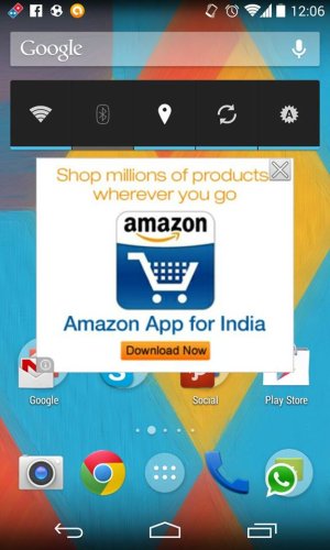

Hi,
I'm getting these ads by Google on my home screen. Even when I don't have any app opened. There is no item related to the as in the notification bar.
Are these default android ads or have I installed some app which is doing this.
Can someone please help me?

Welcome to Android Central! It would help if you could post some screenshots, or describe these ads in more detail. Are they appearing in the Notification Bar at the top of the screen? Are they pop up windows? Do they occur when you're browsing the web using Chrome or another browser?
If they're in the Notifications, swipe down the shade and long-press the ad. Then tap App Info when it appears. That should tell you what app is responsible for the notification.
Here is the screenshot.
They show up at the home screen at random. Sometimes while browsing, sometimes while playing a game, sometimes just on the home screen.
I still havent figured out a pattern.
They never show up in the notification bar. So I can't figure out which app is causing this.

Did they appear very recently? Try uninstalling your most recently installed apps one by one, and check to see if those ads go away.

Try going to settings>accounts>Google>ads> then opt out....BTW, that's the 1st time I've heard of home screen ads

I saw something like this recently on a SGS4 running a AOSP KitKat build, it was some kind of spyware or app that he had given permission to or something... not sure which one, no ad blocker or detector would find anything, the only thing that cleared it out was a factory reset, then even after Google Play restored all the apps, no more ads.

i have the same problem.
it's because you have added a shortcut of a web page to your home screen.
like appdroid.
delete it if you want the ads to be gone.

I found a solution. When the ads pop up. Hit your home button for few seconds to view resent apps if using 4.2 android or whatever technique to see recent apps.
You should see the ads along with recently used apps and the ads are generated by " network service" . go into settings-apps-all apps-scroll to network service and disable or deactivate. It will work. I had the same problem.
I believe it's malware but haven't investigated further why it happen. I will email Google on the issue..

Had the same problem. Go to settings,app manager and search for the app that is sending it. Cant remember its name i googled them till i found the one sending adds

These kinds of ads aren't directly from Google. They're from 3rd party adware that gets installed alongside other apps, usually from shady or unreliable app stores. Stick with the Google Play Store for apps, to reduce your risk for this kind of stuff.
