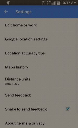

Re: How to change the wrong home address in Google Now
In settings

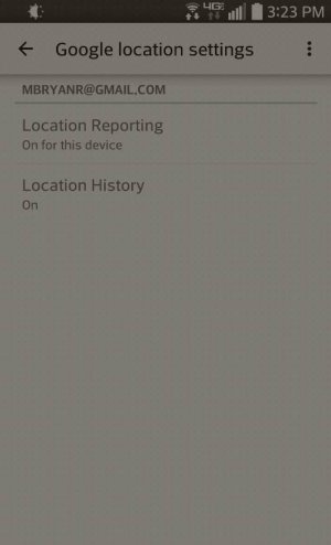

Interesting. Wonder if google sync is on...or possibly location history needs to be on. I know if it is turned off,it retains the previous location information (unless deleted by the user]

Massyboy
Jun 3, 2013
14
Visit site
Yeah, those are both on too. It's all very bizarre. I'm now getting both the old and the new address so it's obviously registering my new address but somewhere my old address is sticking too.

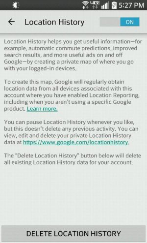

Have you tried to delete location history?
