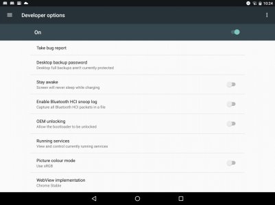

I suppose the USB port itself might be damaged and one or other of the data connections is not working. But I would have still expected to find USB Debugging in the Developer options window but it isn't as you can see in the screenshot below. It is puzzling as my phone with the same software works correctly. The Nexus used to connect with the USB cable but packed up about a year ago. I assumed this followed a software update.

Hmm, strange. You can't scroll down any further in that menu, right? And what shows up if you tap the overflow menu button at the upper right?

Thank you again. In the screenshot above there was nothing below the menu shown (no scroll bar) and the three dots menu just has "Help and Feedback".
