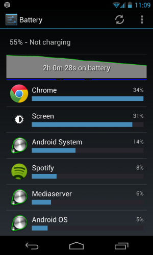

Sorry for the late reply. Me and my friend both have battery widget reborn and his drops at about 1% every 4.5 minutes under similar load and no tweaks. We both use auto brightness and both phones are stock ROM and kernel. I've had the phone powered on for 1 hr 30 mins with 1 hour to OST. Battery is sitting at 60% now with just spotfy running in offline mode. And I tried using EDGE and dropping brightness and it seems to have made no difference. Coverage on hspa and edge are both at 3-4 bars wherever I go. Oh and one more thing... We both charged our phones when they were near 20% or so and we noticed that mine charges alot faster than his... Could this indicate a battery capacity issue? This is my battery use with 1:20 screen time if I uploaded correctly
