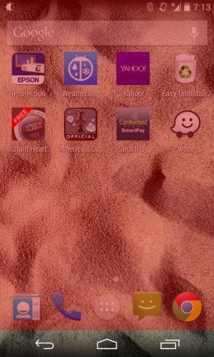

This morning i suddenly get a red tint on part of my screen right above where the buttons are....Screenshot_2014-01-29-07-13-40.jpg
It's not hardware, it's fine on the boot screens.
Any ideas?
TIA

It appears to be an app that you've allowed to draw over your screen, because the navigation bar is totally unaffected. If it was hardware, it would have the red in lockscreens, and your nav bar would also be red.
I'm suspecting it's an app like this:
https://play.google.com/store/apps/details?id=com.urbandroid.lux&hl=en
It layers a red/orange overdraw on the screen making it easier on the eyes when in a dark room (eg late at night) and easier to fall asleep. Carefully go through your apps and check the permissions on each one. Check what each one does. If one of them has been given permission to draw over the screen delete it for now. Once you've figured out which app it is and deleted it, reboot the phone and double check it.

I see you have lux installed on your phone (the little icon in the upper LH corner). It has a setting for observatory mode (looks like 3 stars). Ill bet my life that you touched this on accident. It is on your pull down screen. Touch it a second time and it will reset back to normal.
