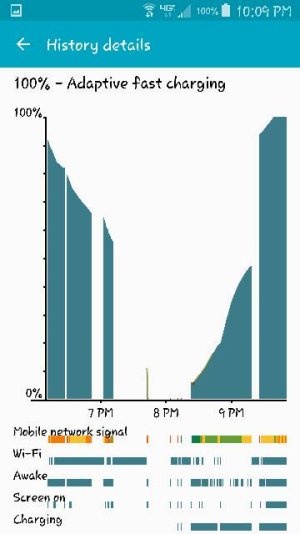

I've had my note 4 for a little over a year. I loved it at first and now I'm thinking about switching to something else. My problem is 1st that I hardly if ever have 4gLTE. Yet my wife on the same Verizon network has a full signal on her iPhone 6s. I drop calls all the time and I also don't have access to the Internet in a lot of places where I'm supposed to have 4g. 2nd my battery after being fully charged at 7am will die by 2pm when I haven't even used it. Then when I do use it I'll go from full battery to 40% in a matter of an hour and about 10 min after that the warning that I have a low battery appears then shuts off yet I plug it in and it says I have 36% battery life. Then I'll turn it on and unplug the charger and it'll turn off automatically with a dead battery. Any help would be greatly appreciated.

One has to wonder if a bad battery that isn't putting out the proper voltage can affect the operation of the device. The battery chart you attached indicates a bad battery, but if buying a new battery is too much of a hardship to invest in then maybe try a reset first, then go for a new battery . . But if it were me given the description of the issues I'd try a new battery first.

I've had my N4 pretty much right at the 1 year mark and I was having the same problems with the battery suddenly dying all the time around the 30% mark if i so much as opened an app. Purchased a new battery and solved the problem.

Thank you for the replies. I bought a new battery which should be here by Wednesday. I'll see how it goes then but I'm definitely going to do a factory reset plus I bought a new 64gb memory card so hopefully that helps. I had an IPhone as well and like my Android much more so definitely don't want to go back
