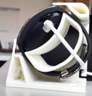

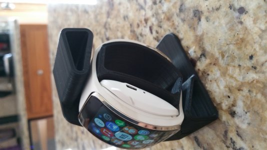

Thanks for posting that file! A buddy at work printed it out for me. I had him change the angle so it faces foward more instead of up. That way I put it on my night stand and its a night time clock.

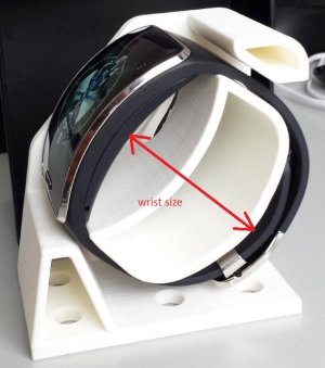

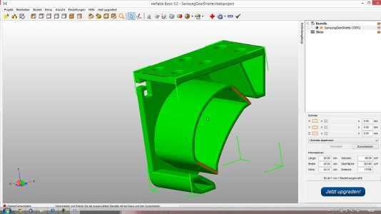

DonShock you can modify the STL file with a CAD program . then you can adjust it to your arm size .

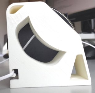

I bought a generic charger without the battery. Im going to glue/double side tape it to the stand and cut the top tab off. The watch strap pulls it snug to the stand. Its about the same size as my wrist so I dont have to adjust it. I plan on cutting the top tab off the charger and letting it sit on the bottom tab

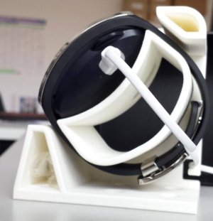

I'm trying to find (and learn how to use) a program to let me do my own modification to the original file. Looking at the side view photo in AnyStar's post above, it seems to me that it can be modified slightly to provide a solution for the broken charger clip issue. If the "top" and "front" edges were extended to form small arms that would slightly overlap the top and bottom edges of the watch, they could be used to press the watch against the charge as it was slid in from the side. This would give the slight pressure needed to get the charger pins to make reliable contact once the clips have broken.
the red lines enough change
