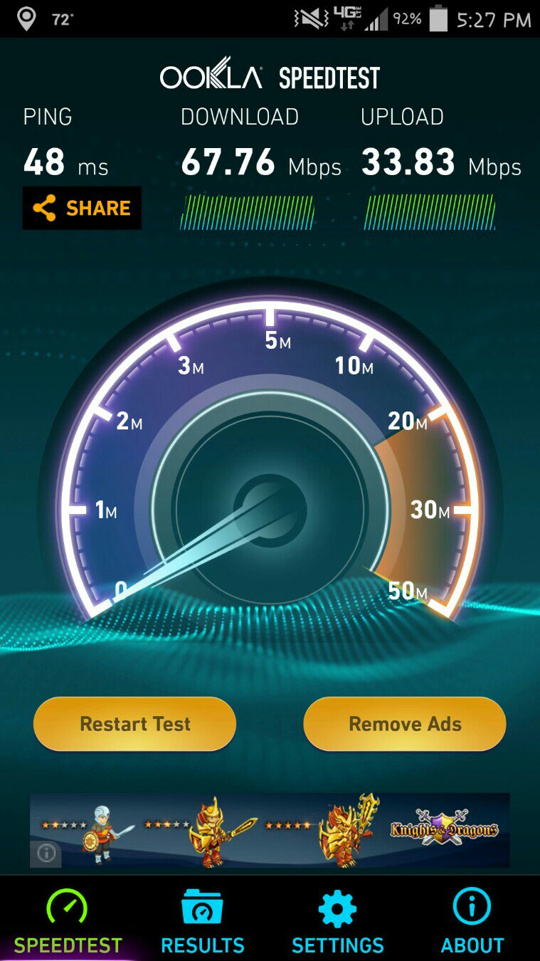

Just noticed that my 4G was on 4 bars, so I did a speed test. It doesn't appear that switching to MJE is affecting the speed any.
