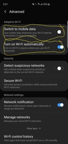

Check these settings in wifi
This how mine looks compare it

You can try to reset Network Settings in settings but you'll need to put your password again and see what happens.
I tried resetting the network and reserving an ip number for the phone. No dice. Works fine on 2.4 so that is what I use now
