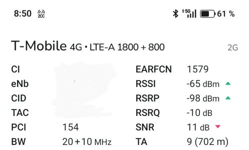

5G mobile network. I live in an area where 5G is not yet available, but it is available on nearby transmitters about 3-4 km away. My old phone sometimes picked up a very weak signal from it, but it couldn't hold out and the phone switched to LTE+. The OnePlus 13 is paradoxically sometimes more sensitive, that is, than ever.. and it probably picks up a 5G signal, in my case the well-spreading 700Mhz band aka Band n28. But it is still so weak that it cannot use it, as if it only detected this band in the air and immediately wildly indicated 5G on the signal icon. I check which network the phone is actually connected to without any fabrications via NetMonster, thanks to which I know that the OnePlus13 simply distorts or incorrectly evaluates the signal situation.

I see this every day... (including a location with only LTE800 and there it also indicates 5G, however, after some time, on the order of minutes, the correct LTE indication appears.) You don't understand... if I were in a city where 5G is basically almost everywhere, I probably wouldn't worry about it, but this seems like a pretty monstrous bug to me. Unfortunately, OnePlus mobiles are basically not discussed on the Czech Internet, either people have it and everything is ok or they live with existing errors or choose other brands.

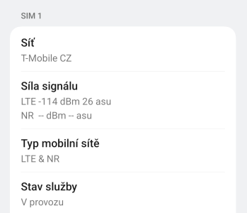

Now for 2 days the phone does whatever it wants, sometimes it indicates LTE correctly where there is LTE, sometimes 5G. What is certain is that it receives a weak signal just as poorly, unfortunately maybe a tiny bit worse than Samsung.
You can see on the screen that LTE is weaker, but there is no 5G/NR, but even zero zero nothing is probably enough to indicate 5G. I don't understand it and it's the biggest shoe.
