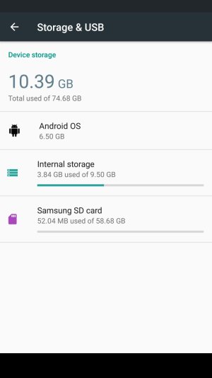

My phone shows storage as below when I format the SD card as adoptable storage.

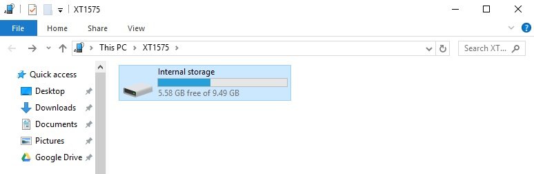

My PC shows storage on the phone as below.

Thank you! That helps clear up a lot for me, actually. It is also interesting to see that the phone will use the internal storage before the SD card. This is a good thing, actually, as I thought I had read somewhere that it would default to using the SD storage first...
Hmm, you also don't have many apps installed, do you? Not that this means anything... it's all just data right now for me.
