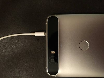

OK I tried several different pairs of headphones and none of them will plug in all the way, I'm pushing pretty hard.
Is your guys headphone jack really easy or hard to plug-in. I have a set of iPhone earbuds and they don't seem to plug in all the way and I can't get any audio out of them.
Mine definitely has an unusually strong point of resistance that I have to push past. If I don't push the pin in all the way, the volume is incredibly low and sometimes doesn't even engage the speaker cut off.
Just ordered a replacement. I was pushing so hard I thought I was going to break the phone. 😬
That was as far as I could push it in.
That's odd. I have a pair of the Apple headphones that are sideways and they fit all the way in. The white part rests against the phone.

Or it could just be that those people who are having issues with earbud audio volume on the 6p just arent getting their plug pushed in to the jack all the way?
With practically every audio jack ive ever seen, you should be able to press the plug all the way into the jack. if you dont, you get issues with audio. I think some people may just be afraid of breaking their phone because they dont feel they should push that hard (and you shouldn't have to, really) and they arent getting the plug in the jack all the way, and because of this volume is sacrificed.
