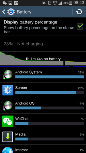

this morning I woke up my phone was 100%, after an hour i went out to work, my phone's battery dropped to 33%. I was shocked! Because this is abnormal. My phone was quite alright yesterday (full battery could be used 1 day +) and i didn't update or install any applications.
i checked the android system, it was only on for 6 minutes, so it shouldn't be using that much of battery.
what happened to my phone?:confused:

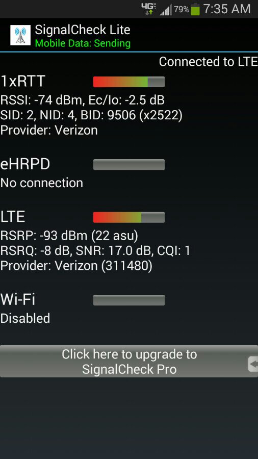

It's also possible that you had a weak Mobile data signal, which would go through power like the proverbial hot knife through butter. You could use something like SignalCheck Lite http://market.android.com/details?id=com.blueline.signalchecklite to monitor the various signal qualities (cellular, mobile data, Wi-Fi) and see if any of those are responsible for your battery behavior.

that's what I'm thinking as well. Because before it went crazy, a whole day work (8hour, no game play, only using a instant messaging chatting app) would only cost me about 40% battery, but today it suddenly becomes like this, I wouldn't consider it's caused by an old battery problem.
I turned Flight mode on, turned off the phone and took out the battery, waited for 30s and put back in. the battery percentage suddenly increased from 21% to 35%. And now I'm charging with the Flight mode on. Let's see if it would be better
