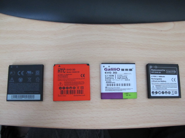

From Left to Right:
HTC OEM, Chichitec 1930mah, Galilio 2000mah, Noname 1800mah

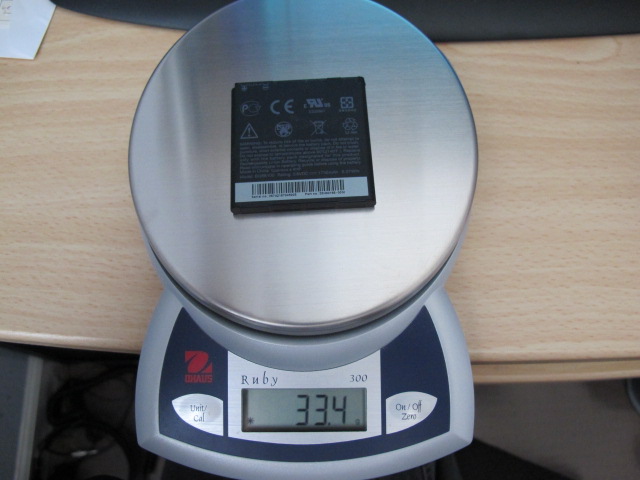

HTC OEM = 33.4 grams

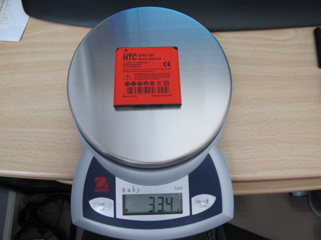

Chichitec = 33.4 grams

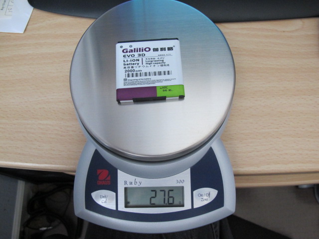

Galilio = 27.6 grams

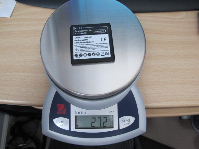

Noname = 27.2 grams
I have another Anker battery coming and I will update this post as soon as I get it.
So far only the Chichitec's perform close or better than the OEM.
Sticker pulls from the Noname and Galilio batteries yielded 1000mah stamps.
No stamps for the Chichitecs.
