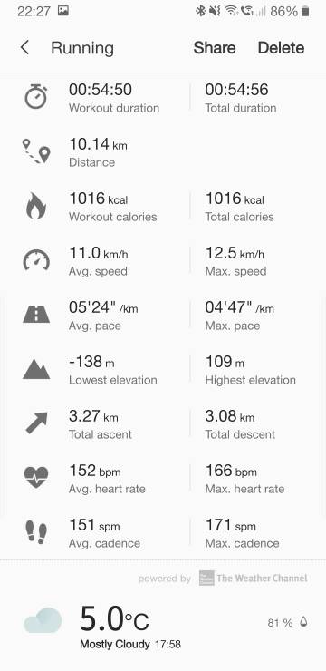

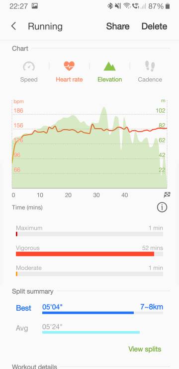

You should be getting elevation on your runs - see pics of one of my runs. I don't know why you aren't. I know that's not very helpful, but I don't know the reason why.
Couple of things to check:
Obviously check location is on in settings and set it to GPS and wireless. Also, before you go for your run, choose run as exercise and BEFORE you press 'start running', scroll down with the bezel and select high accuracy.
Tell us how you get on.

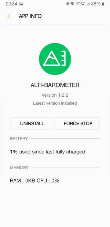

Also check you've got this version of Alti -Barometer (on phone go to wear app/settings/apps/alti-barometer).

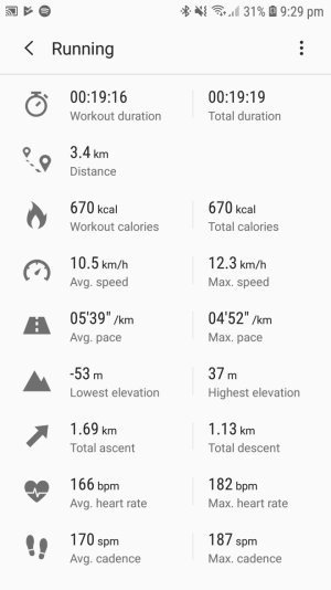

Since the latest update which outlined assessing the heart rate monitor issues (which I never experienced).
I have been getting a calorie readings wayy higher than it should be, see attachment.
It's been 600-750 odd for a 20 minute run. Before the update is was fairly typical with what you expect.
Anyone else had this issue ? Annoying that it's only happened after the update.
Also have issues with elevation if I forget to reset the altimeter.
