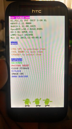

In the boot loader, the top of the screen says ***LOCKED*** and S is on. Im new at HTC phones so is this normal?
Yes, but the bootloader can be locked and relocked and I'm pretty sure S can be turned on and off multiple times as well.
This is normal. It means the phone has not been tampered with. Although in this case, it seems it was made to look stock since it has SuperSU on it. You can get the bootloader unlocked and flash a ROM. S-OFF is not necessary to flash a ROM.

Alright so I think this phone maybe repairable. I first need to get a new battery that's fully charged because the current one is at 3%. Secondly, I can use the htcdev.com to unlock the boot loader correct? After that, re root it (multiple root checking apps say its not rooted), and put a stock ROM on it? Sound right? I know its hard to diagnose without seeing it but based on my problems does this seem like the right course of action? Here's a pic of the boot loader...2014-04-29 10.10.37.jpg
Alright so I think this phone maybe repairable. I first need to get a new battery that's fully charged because the current one is at 3%. Secondly, I can use the htcdev.com to unlock the boot loader correct? After that, re root it (multiple root checking apps say its not rooted), and put a stock ROM on it? Sound right? I know its hard to diagnose without seeing it but based on my problems does this seem like the right course of action? Here's a pic of the boot loader...View attachment 115420
Yes. Unlock bootloader, flash a recovery, root. and then flash a ROM. Stop when you get root because it's a little tricky flashing a ROM with S-ON.
