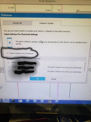

In smartswitch preference I circled what needs to be checked 20190614_151729.jpeg
Also try to initiate software recovery if that dont work , you need to flash through Odin.
mustang7757:
Thank you very much for the information. Yes, I put the check mark on the Software Pre-Download. What I couldn't make it work is the emergency software recovery. As I said before, it keeps asking for a recovery code. As I gather from the video about Odin, it's going to take a while to be familiar with it, to re-install the firmware. Thanks again for the help. wp
