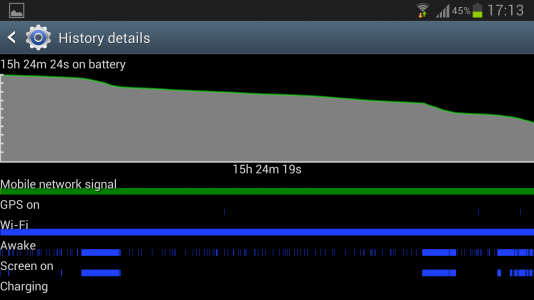

Hello fellow Note 2 owners.
New member here, so please treat me kindly :)
My wifi stays on during screen off, and drains battery. I've so far done these:
1. Settings > wifi > advanced > keep wifi-on during sleep > never
2. Google Now > Settings > Google Now OFF
3. Settings > Location Services > Location and Google Search > OFF
4. Phone > *#0011# > Wifi Power Save Mode > ON
5. Maps > Settings > Location Settings > Everything OFF
I don't know what else to do to keep Wifi OFF during sleep. I believe some application is keeping the wifi on somehow? Is there any app that can report me what application is causing the problem?
Btw, my phone's "Awake" stats is weird. Looks like it doesn't sleep well rested, and maybe that somehow causes the wifi to stay on? I'd like to track down the application causing this.

It looks normal. Perhaps background sync was keeping it awake. But those awake status were rather short and you should not be too worried.

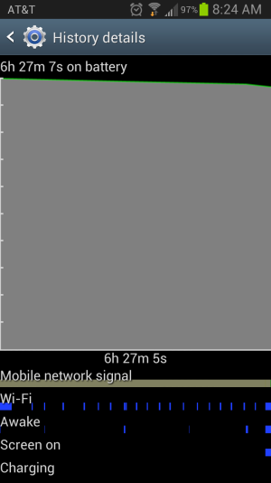

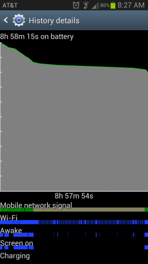

I've been having the same issue you are. Also new to android, and although the note 2 has ridiculous battery life, I've been using BetterBatteryStats to make sure my phone is not waking up during deep sleep. One issue I was having was apps using wifi to check if any new data needed to be pushed. Biggest problem I've been having is maps.
On my quest to properly set up my sync intervals so that my phone will stay in deep sleep when I want it to, I tried changing my wifi settings. I wanted my wifi to stay off during sleep because I don't use my phone for long periods at a time. If the phone can stay asleep, battery life will trickle down. But I ran into the same issue you're having. the two attached pictures shows "Wifi during sleep only when plugged in" and "never on sleep". However as you can see, neither setting will keep wifi off. My phone will, on a consistent basis, wake up from sleep to reactivate the wifi. This cycling issue only happens when the phone is dormant. If the screen is on, I have no problems with wifi.
In my quest to understand the way Android checks for data, these two images were taken with all location, google now, push, and sync settings turned off after a reboot.
It seems like the only way to control wifi being active is by manually shutting off the wifi when not in use (not really the biggest deal). I have to say though, as my first android phone, maybe I just don't understand the function of the wifi settings and it is working as it should be.
I've found the most optimal set up for the lowest awake vs screen on ratio to be with google now off, wifi off, location services off...pretty much everything that makes a smartphone a smartphone. Of course, buying such an expensive device to do all these things and then turning them off is really silly. And it seems like the only way to make the note 2 not last the whole day is by really trying to suck the battery down. So this analysis is more just a little hobby than a serious concern.
But I'd like to find that sweet spot where my phone will not be waking up unless it's for things that I want pushed to be pushed. I have unlimited so staying on wifi constantly is not a priority. I'd much prefer my phone to be syncing in the background at predetermined intervals (like at night when plugged in on wifi). I'll slowly be turning on different push settings and hopefully I'll understand my phone better. But I'd like to just leave wifi on, pushing data when it should and not have issues with it constantly pinging for data over periods of sleep.
(Contrary to what others have said, I've read its not as simple as "leaving wifi on all the time = more battery" when you consider how wifi behaves during sleep)
EDIT: In rereading this thread, I see we actually have to different problems even though our settings are similar. huh... the wifi advanced settings sure are funky...
