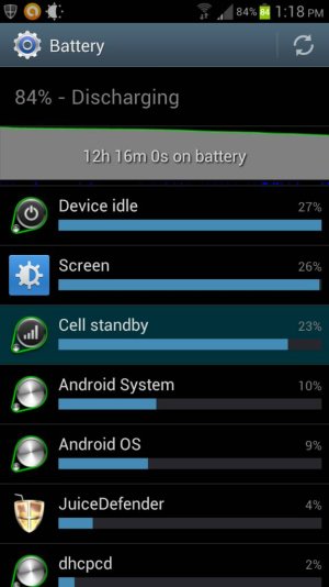

Lol thought you guys might like to see this.

84% after 12 hours. Not bad huh? Granted I haven't used my phone much in the last 12 hours but I don't use any battery saving strategies. Have auto sync set, and I even use a live wallpaper.

Seriously? I have never seen these numbers unless the phone sat on the side table in sleep mode.

According to that screen shot that's exactly what his phone did.
Or he charged it but not enough to reset the counter.

Or he knows how to use photoshop. Which would sadden me. It's impressive.

Lol no photo shop or any other bs going on here guys. It's legit. That's the power and beauty of Scotts cleanrom. Amazing battery life. Amazing smoothness and speed. Also, I admitted that I hadn't used my phone much during that time but it by no means sat there not being used at all. Just light use and the power of a great rom. Simple.

but not overclocked lol?
or set with a low minimum clock speed?

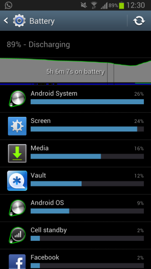

Hi
I am from Singapore and I don't understand why the battery life on my S3 is so poor. I have tried switching off WiFi and doing all the normal battery saving steps but there has been no improvement at all. I don't understand why with 89% battery I only am getting 5h battery time. I have a good strong signal most of hte time.
Could someone please tell me what the problem could be? :(
Thank you

Poor? You've been running on the battery for 5 hours and used only 11% of capacity. At that rate, you could get 40 hours and still have some battery left. Why do you think this is poor?
